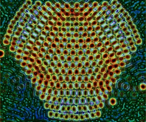

Engineers from Stanford's Institute for Materials and Energy Sciences, inspired by wonder-material graphene, have created a new material dubbed 'molecular graphene' which promises to revolutionise the world of electronics by creating mass-free light-speed electrons.

On the surface, the research carried out by Hari Manoharan and his team isn't quite as practical. Described in a paper dubbed 'Designer Dirac fermions and topological phases in molecular graphene,' published this week in Nature, the team's research appears dry and academic. Scratch beneath the surface, however, and it holds substantial promise for the future of electronics.
Inspired by the multifarious possibilities of graphene, Manoharan and his team worked to convince electrons travelling on a copper sheet to organise themselves into a honeycomb arrangement. Placing individual molecules of carbon monoxide onto a copper sheet, they were able to force the electrons on the copper surface to form a graphene-like lattice arrangement. Moving the carbon monoxide molecules controls the electrons by repelling them.
Using this control, Manoharan's team was able to trick the electrons into behaving as though they had been exposed to a massive magnetic field in the range of 60 Tesla - some 30 per cent stronger than anything ever recorded. The results were staggering: the electrons began to behave as though there were completely free of mass, travelling through the copper at the speed of light exactly as they would in a vacuum.
