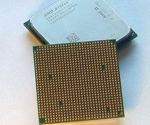

The new 'Revision E' Athlon 64 cores sport support for DDR500 memory, according to a report at Anandtech.
The 'E's sport a good few improvements over the previous stepping of Athlon 64s, including support for SSE3 instructions and a process shrink to 90nm.
However, most interesting is a range of new memory dividers that allow for speeds far higher than the standard 200MHz. For example, an Athlon X2, using the highest divider, can run at 266MHz memory speed, without overclocking either the HyperTransport bus or the processor itself.
As Anand points out, Athlon processors aren't usually very bottlenecked by memory bandwidth - indeed, it's always been one of the strong points of the platform. But with dual-core chips sharing that bandwidth, there is potential for it to become a slow-point, so the support for DDR533 in the X2 is definitely welcome.
