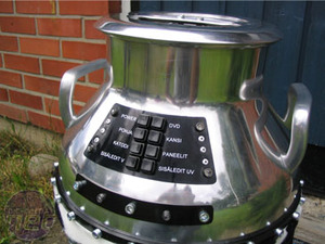

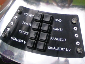

Here are some photos of the case at Assembly, showing off the internal lighting. All this lighting required me to design and build a control panel for all the switches - this was a lot of the work that I hurried to complete, and sadly don't have any photos of the construction.
Tonkputer by Nev@Lehmä System Installation Tonkputer by Nev@Lehmä System Installation
Here is the final product. The Power and DVD buttons are self-evident, but let me translate the others for you:
<ol><li>Pohja = Bottom to switch the LEDs underneath the case, which I didn't have time to install before the competition.<li>Katodi = Cathode the cold cathode lighting, again, not yet installed.<li>Sisaledit V = white LED bright white LED lighting inside. <li>Sisaledit UV = UV LED Ultraviolet LED lighting inside; certain motherboard components have UV paint.<li>Kansi = Cap will switch on some LEDs lighting the cap fan when i install it.<li>Paneelit = Panel activated the LED lighting on the control panel, and the DVD drive door.</ol>As you can see, there were many things that I didn't get done before Assembly, but I hope to finish them off soon. For example, I ordered some UV-reactive IDE cables, but they didn't arrive in time. The cow looks pretty cool under UV light as well.
