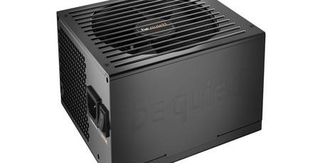

Be Quiet! has built a solid reputation for itself in the PSU market, and it's undoubtedly looking to continue this tradition with the latest iteration of the Straight Power family. The Straight Power 11 is available in six capacities – 450W, 550W, 650W, 750W, 850W, and 1,000W – to cover a broad range of systems and budgets. We have the 850W one in for review, which retails for between £150 and £170 depending on where you look. This is pretty expensive, even considering the 80 Plus Gold and fully modular credentials it carries, so let's see what else it brings to the table.
Power supplies are rarely exciting visually, and the Straight Power 11 plays it safe with its smart all-black design. Importantly, it feels very well made and is up to Be Quiet!'s usual standards in this regard. Our 850W model is 170mm deep, which is about what you'd expect. It does make it better suited to larger cases, but given that the capacity is so high this isn't likely to be a problem; 850W is well suited to high-end, multi-GPU systems and workstations.
