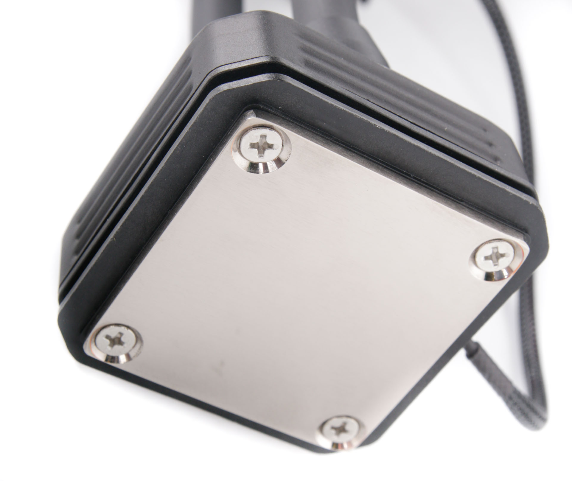

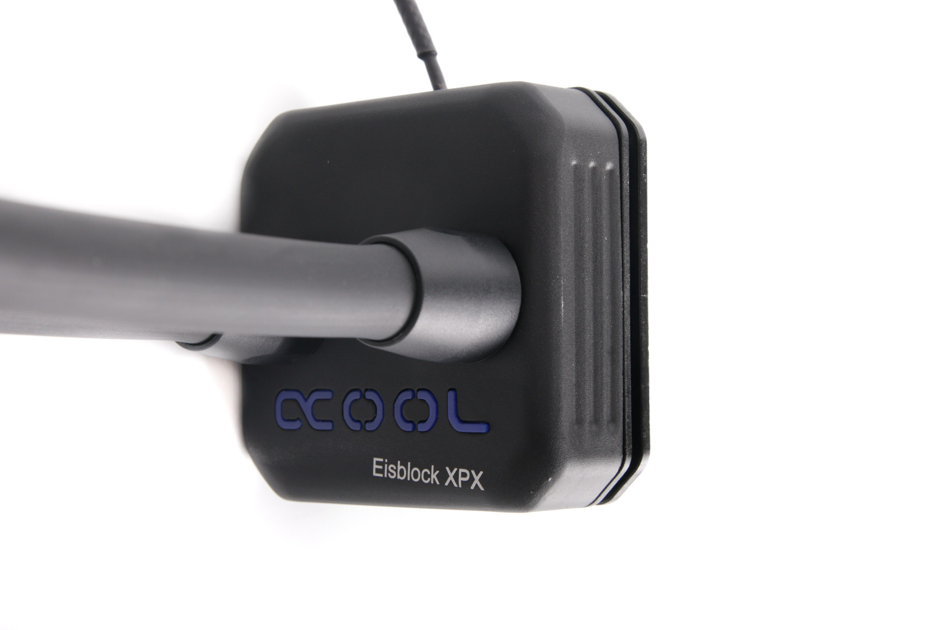

Cooling your CPU is an Alphacool Eisblock XPX, which supports all current CPU sockets including Socket TR4 plus plenty of older ones too including LGA 1366, although LGA 775 isn't on the list (upgrade already!). Installation is relatively simple, but Alphacool's mounting mechanism is a little archaic and fiddly with springs, screws, and washers to deal with and even nuts on mainstream sockets. It's difficult to go wrong, though, and the manual is decent enough with large colour diagrams, so even a liquid-cooling newcomer should sail through.
The water block sports a blue LED light illuminating the Alphacool logo on top courtesy of a three-pin power cable, with metal clips hooking onto each side catering for AMD and Intel sockets. The water block section is detachable thanks to quick-release fittings on the tubes, which unscrew and allow you to add other components or just detach the water block for easier fitting without draining the loop.
