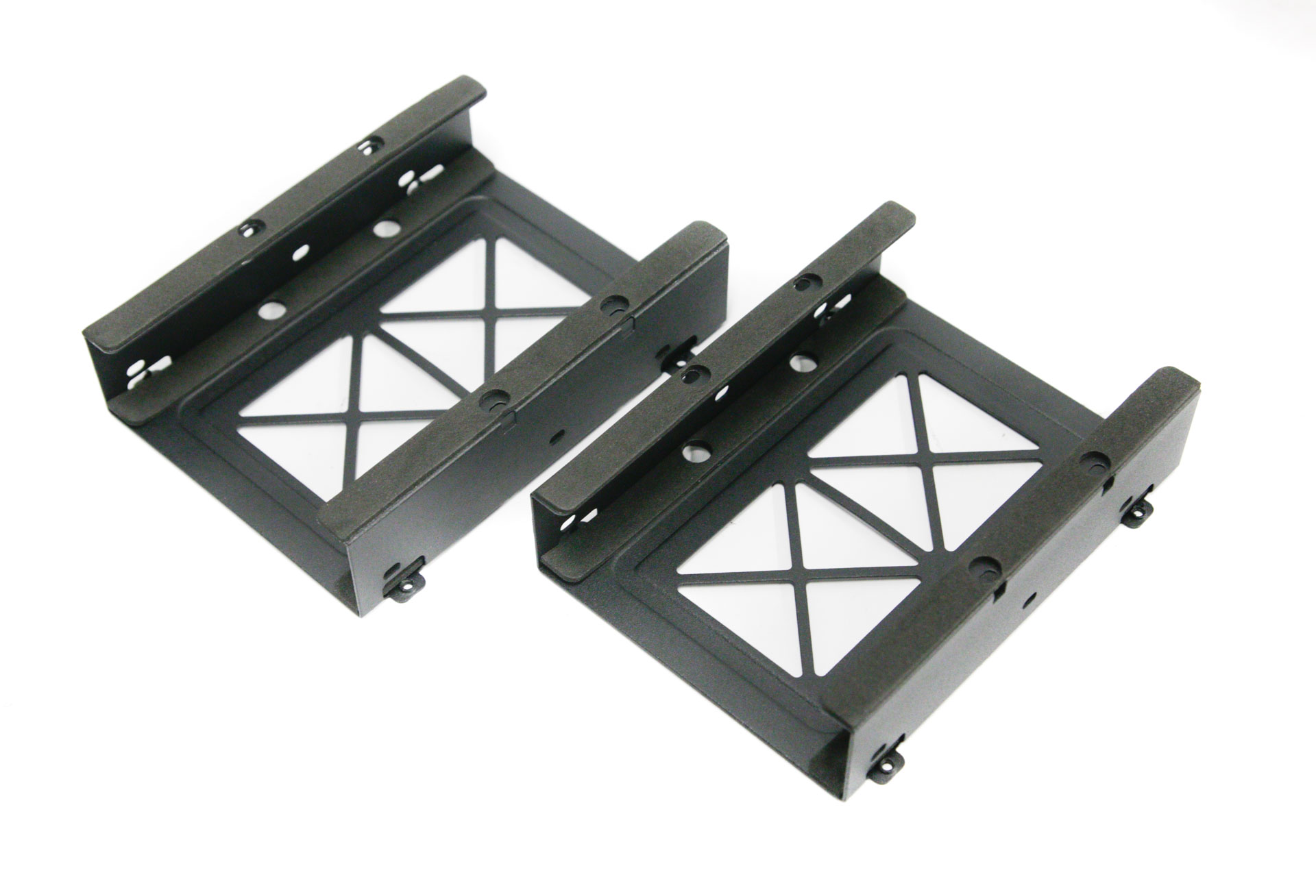

In addition, Deepcool supplies two 3.5" trays that cater for two hard disks apiece and can be mounted in front of the PSU cage on the floor or internally to the back of any of the 120mm fan mounts - a nice way of building flexibility into things. The Macube 550 is maybe not as storage-focussed as other E-ATX cases out there, then, but we'd imagine this is enough potential for the majority of potential owners, even you're planning on transplanting a few hard disks from your old build. Needless to say, installing the above trays will potentially see the clearance for radiators at the front of the case reduced depending on where you put them.
