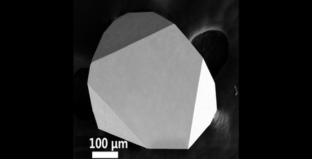

The team built on work from the Naval Research Laboratory and Boston College which highlighted boron arsenide - stable and non-toxic, the team claims, despite containing arsenic - as a material which could approach diamond in thermal conductivity. Initial efforts by Lv and colleagues to prove the theory in the lab were only partially successful: The material produced showed a thermal conductivity of 200 watts per metre-kelvin (200W/mK) - higher than silicon at 150W/mK but considerably below the 2,200W/mK of diamond. Diamond itself, meanwhile, isn't a great choice for semiconductor applications: Natural diamonds are expensive due to artificial market constraints, while lab-grown diamond films have structural defects Lv claims make them ill-suited to electronics projects.
'We have been working on this research for the last three years,' Lv explains, 'and now have gotten the thermal conductivity up to about 1,000 watts per meter-kelvin, which is second only to diamond in bulk materials. To jump from our previous results of 200 watts per meter-kelvin up to 1,000 watts per meter-kelvin, we needed to adjust many parameters, including the raw materials we started with, the temperature and pressure of the chamber, even the type of tubing we used and how we cleaned the equipment.'
