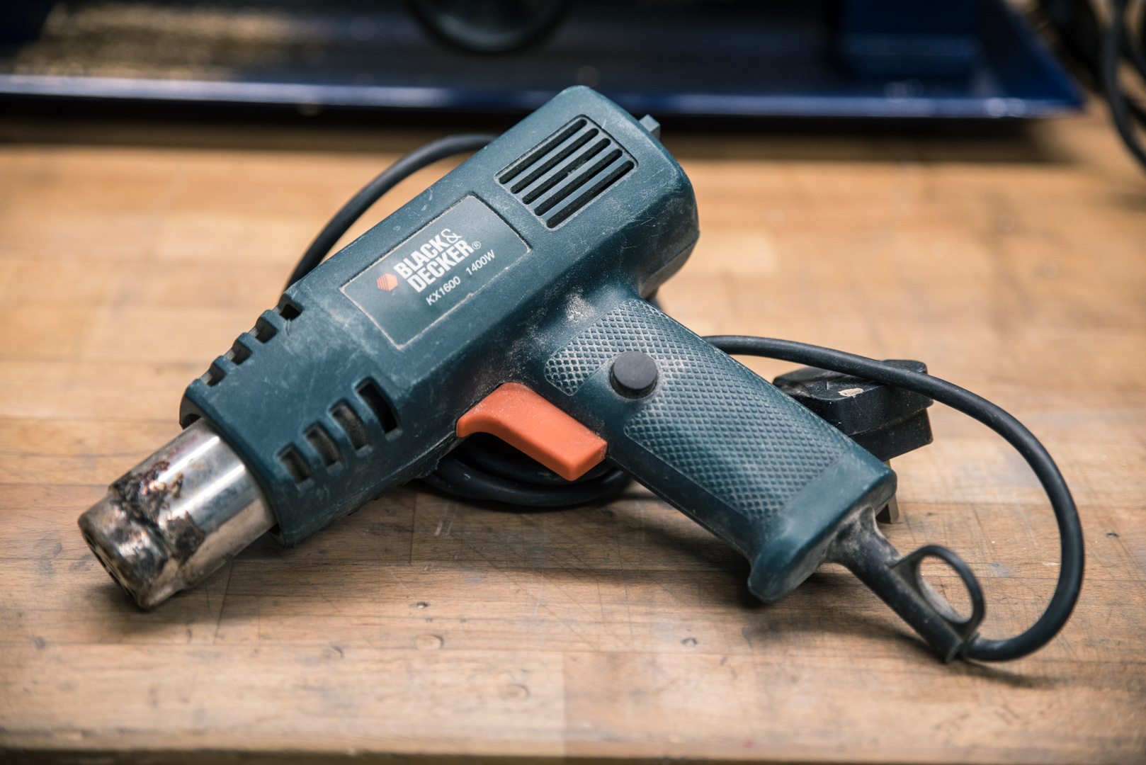

Okay, I'll admit that I simply have too many heat guns. I don't particularly collect them on purpose, they just sort of accrue over time, but for the purposes of this article it's rather convenient. In the above photograph I've ordered mine by the extensiveness of their feature set, which matches up quite evenly with their pricing too. Starting on the left is a trusty Black and Decker KX1600 that must be as old as me, followed by Alphacool's HardTube Heat Gun Pro 2000W that you can find on its online store, then stepping up to DeWalt's DW340K (mine is the older version), and lastly the Bosch GHG 660 LCD Professional Heat Gun.

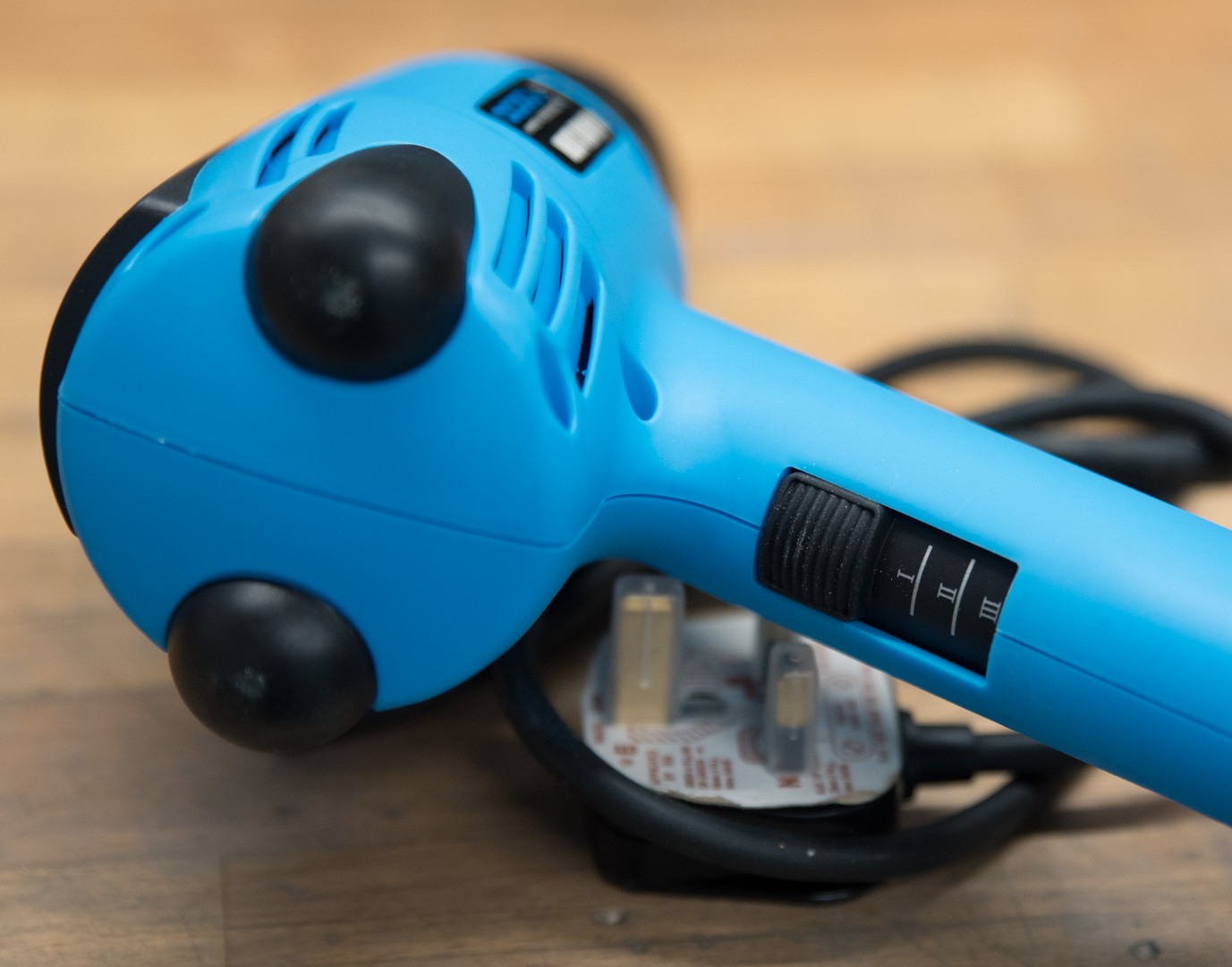

Both the Black and Decker and the Alphacool sit firmly in this category. They're simple tools that heat stuff, nothing much more than that. Typical of basic heat guns, they lack precise temperature control, and in the case of this B&D, any control at all. The Alphacool has a simple three-step strength switch, which will help to provide a modicum of control.
Looking at the wattage of both units, the B&D is 1,400W and the Alphacool 2,000W, which are fairly typical figures. They will heat up quickly and be good for most jobs if you keep an eye on things. PETG in particular can overheat very easily, so it's important with units like these that you're careful and look out for when the tube has reached the correct bending temperature. Similarly if using for heatshrink, make sure to observe when the tube has completely shrunk and also to not accidentally overheat other areas such as sleeving material.

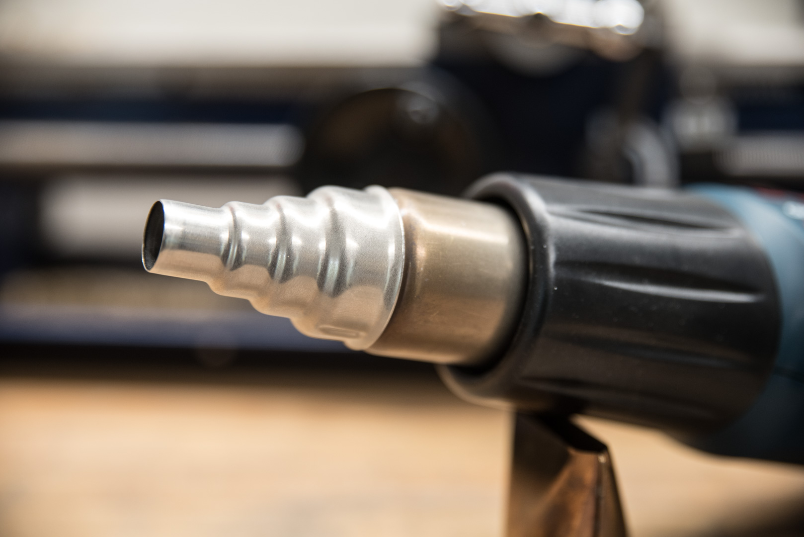

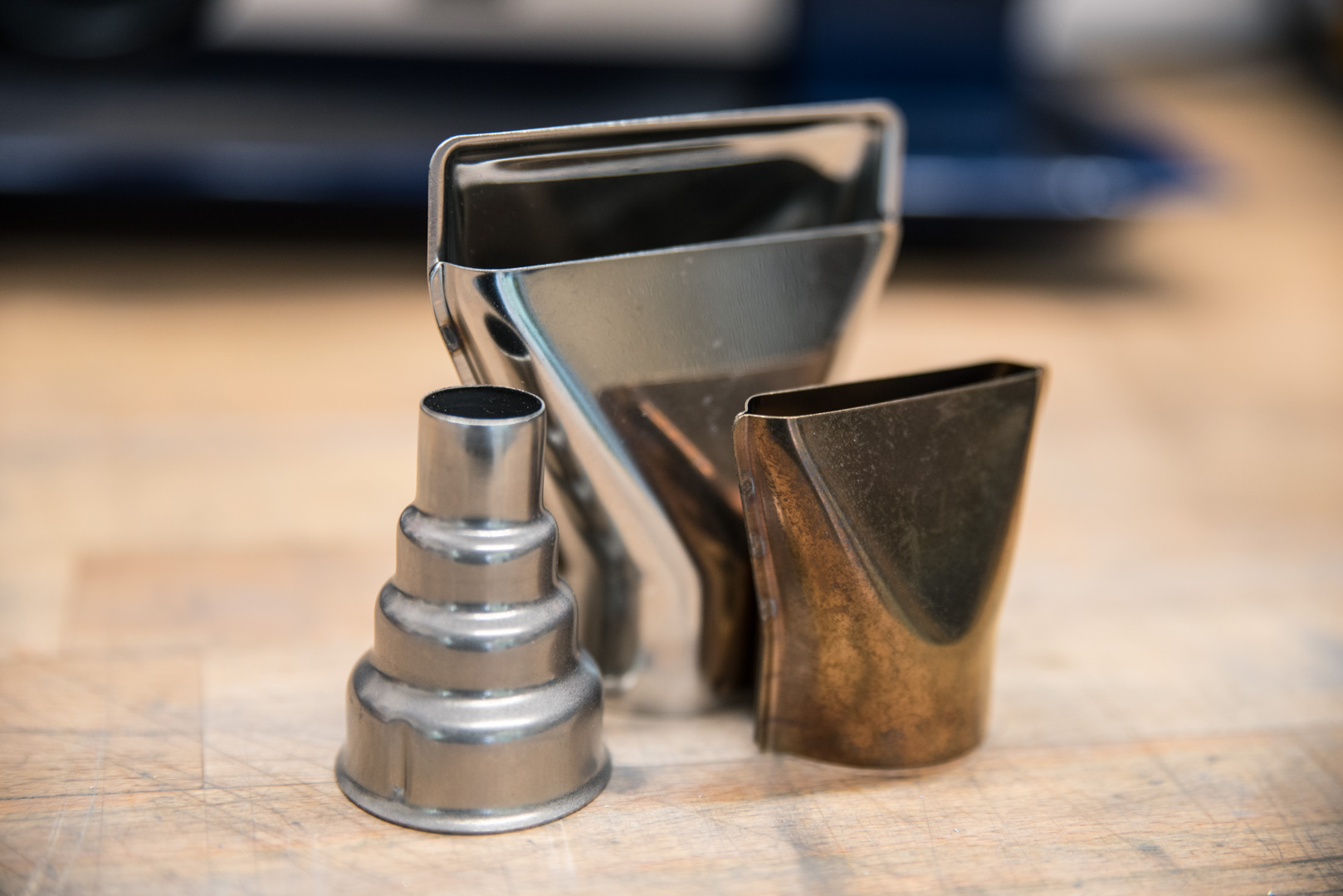

One final thing worth considering are the various accessories that augment a heat gun's capabilities for particular tasks, such as nozzles. Many guns will come with a selection of these, but if not they can be picked up cheaply online. Quite often they can be very helpful for performing specific duties like soldering piping or stripping walls. Personally, I like to use the narrow fan-type one for cabling, as it means I can more easily position a portion of the wire/heatshrink over the airflow. This makes it simpler to keep heatshrink untouched compared with the standard nozzle.
