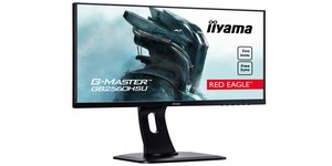

The G2530HSU gives you a 24.5” viewing area for its 1,920 x 1,080 resolution. Most specifications are fairly by the books for a TN panel, although the 1ms promised response time is a further indication that this is mainly a screen for gamers.
The monitor itself is smart looking with a very minimal plastic border around the screen at the top and sides, although there is a thin, black, in-panel border around the viewing area as well. Along the bottom is a plastic section with a brushed metal finish that's matched by the base.
The screen only takes a few moments to construct; the stand slides into the monitor and is then attached at the bottom to the base with a single thumbscrew. Physical adjustments are sadly limited to tilt only (up to 5° forward, up to 22° backward), and this is made more annoying by how close to the base the screen sits; it feels sorely lacking in height. You can, at least, use the VESA wall-mounting system, but this seems like it will be a niche market for budget screen shoppers.
All ports at the back are down-facing, and this includes the two USB ports and headphone/audio out jack. The USB hub only meets the 2.0 standard as well, so we can't see it getting much use at all. VGA, HDMI, and DisplayPort inputs should cover most users (HDMI is the only display cable supplied), although DVI in place of VGA would have been better in our opinion. Dual 2W speakers are built into the screen, but the less said about them, the better.
