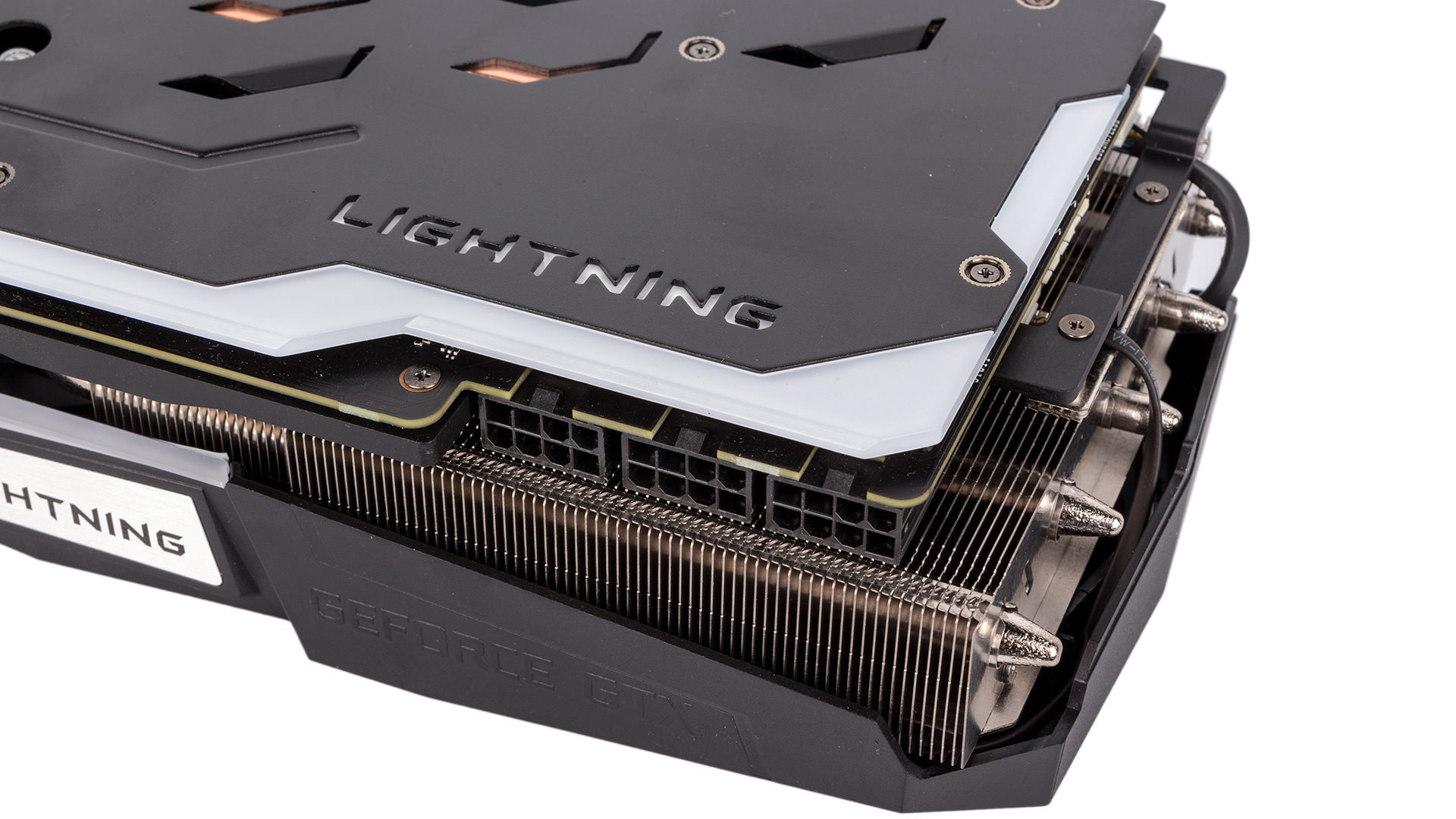

MSI makes a big deal about how this card is built for overclocking, and the most obvious sign of this is the trio of eight-pin PCIe power connectors slightly indented along the top edge. This means you can provide up to 450W of additional power to the card – far more than any overclock will ever need, even with sub-zero cooling. A single six-pin to eight-pin PCIe adaptor cable comes with the card.

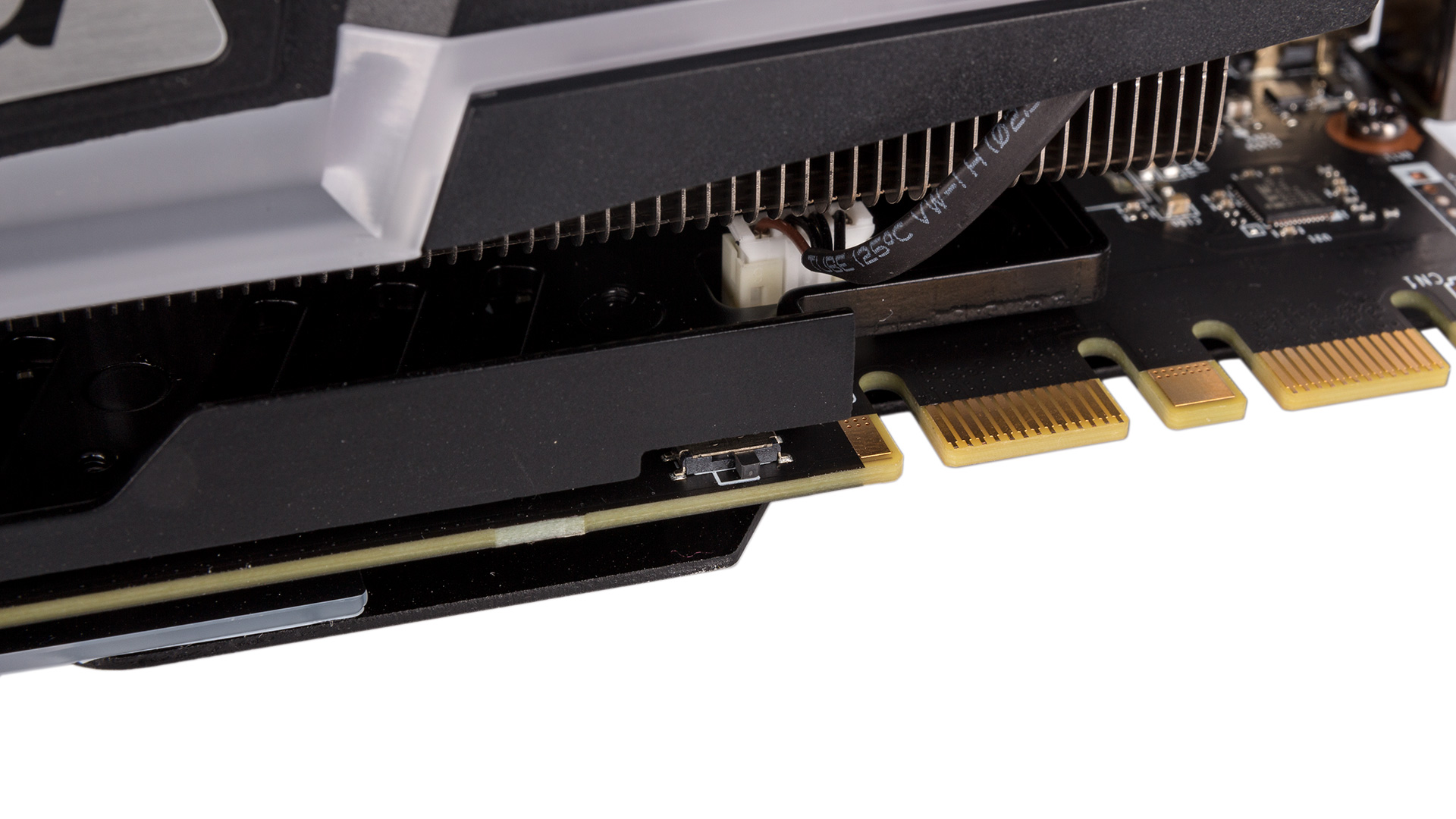

In case it wasn't already obvious, this is not a card built for your Average Joe. Extreme overclockers looking to break performance records are within the niche target audience here, and the dedicated LN2 mode switch beside the SLI fingers confirms this. Switching to LN2 mode disables the card's onboard current, power, and thermal limitations that traditionally stop regular users from breaking things. If you're pouring liquid nitrogen onto your components, that's not really a concern, and this switch saves you having to do physical modifications.
In a similar vein, MSI has built in a trio of readily accessible voltage check points on the right side of the PCB for monitoring GPU, memory, and PLL voltages. It supplies a couple of cables for using these connections too. With the latest beta version of the MSI Afterburner overclocking utility, you also have direct digital voltage control not just for the core but also for the memory and two auxiliary onboard voltages which we're told control the PCIe bus voltage and that of the channel between the GPU and memory. Sensors on the card also allow Afterburner to report more temperature readings than usual. Again, all of this is really about making the lives of extreme overclockers easier.
While we suspect that most of the 3,000 units produced will spend much of their time being cooled by liquid nitrogen, MSI has still produced a monster air cooler. The PCB is sandwiched between two metal plates, both of which have integrated heat pipes (yes, there's a backplate heat pipe). These add rigidity as well as boost heat dissipation, with the one on the front of the PCB covering practically the entire area and thus all VRM and memory components.
The main heatsink is the real beast, featuring a nickel-plated copper baseplate that feeds six heat pipes (two 8mm, four 6mm) and two separate, densely packed fin stacks. MSI claims that this heatsink has an area that's almost 55 percent larger than the cooler on the Founders Edition card – something we have no trouble believing.
