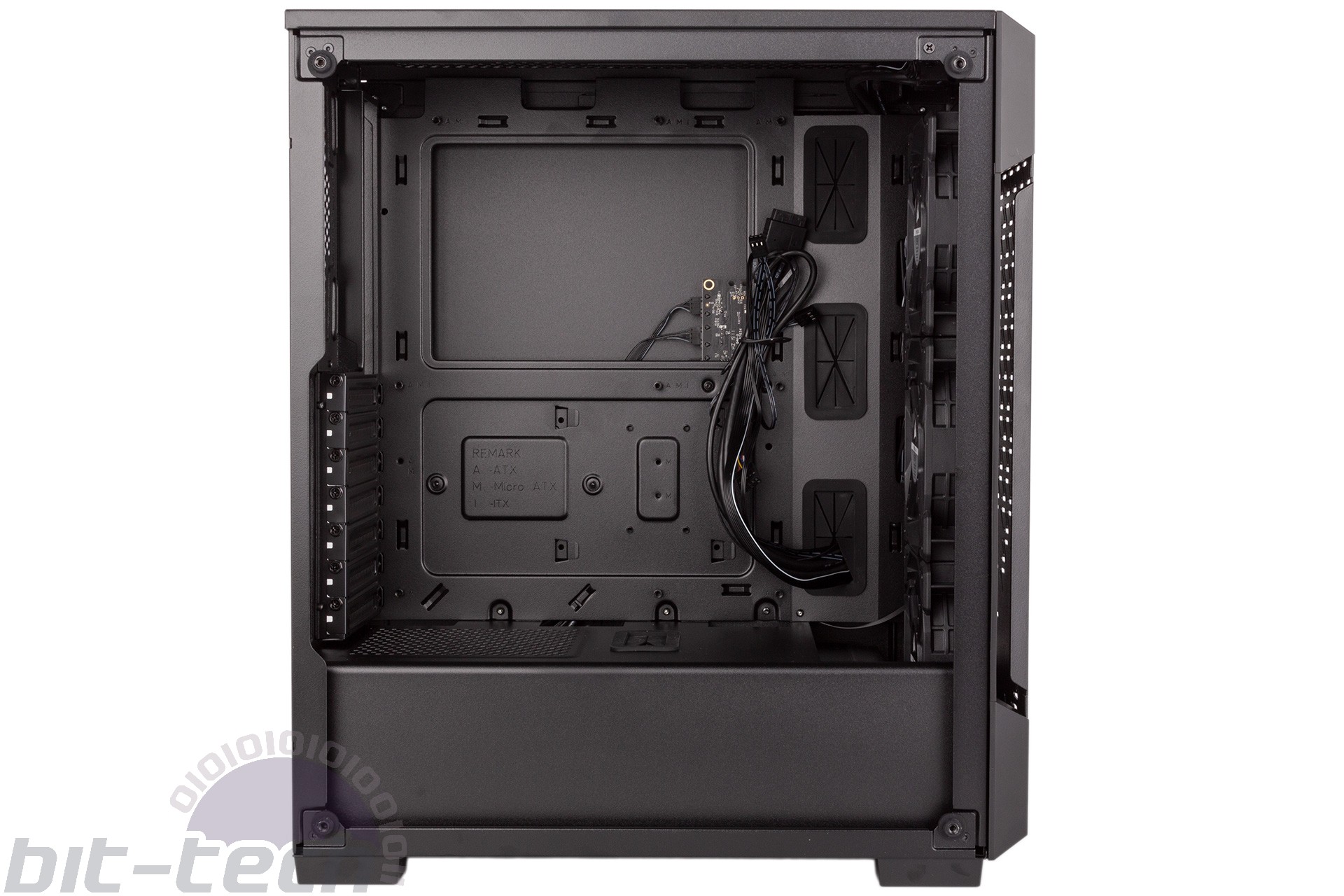

Inside is a standard tower layout by today’s standards. Corsair has kept the steel shroud riveted in place, and it’s part-perforated and also has a front cutaway to make room for radiators. The 220T RGB is a stubby case, but you still have room for 300mm-long graphics cards and 160mm-tall CPU coolers. That’s enough for most bits of kit but by no means all. Motherboard standoffs come pre-installed, but PCI bracket screws are not thumb-accessible.
For radiator placement you’re primarily looking at the front, where 360mm and 280mm units are supported, and the roof, where offset mounts allow 240mm radiators too. You’re primarily going to be looking at slimline AIO radiators in a case like this, so this level of support is fine. Full DIY setups are of course possible too, but there’s no built-in support for pump or radiator placement.
