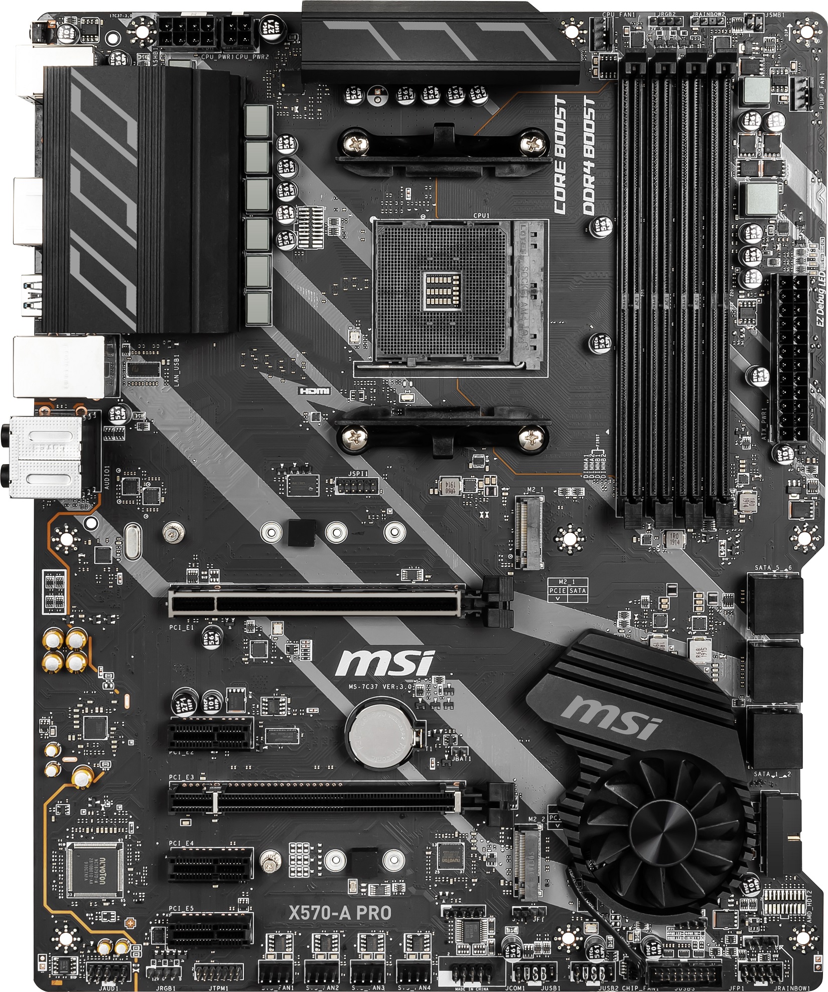

The board is fairly plain to look at apart from a patterned PCB and MSI's signature X570 chipset fan, which, incidentally, was just as quiet as the one on the Prestige X570 Creation, rarely spinning up despite the fact its heatsink is far less bulky than that on the more expensive board.

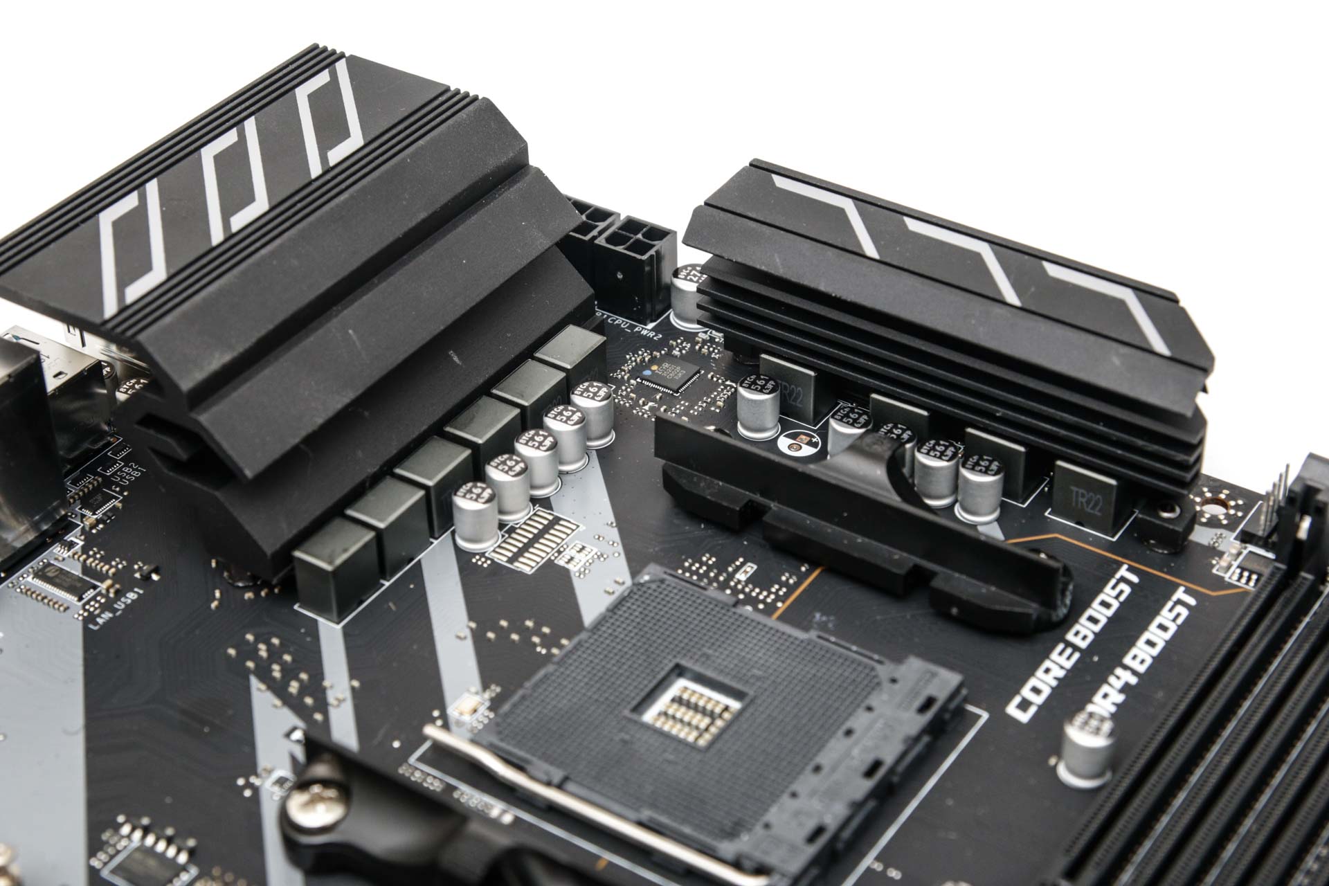

The VRMs offer a relatively lowly eight phases to the CPU (10 in total), and under load these did get undeniably toasty, with the software reporting 78°C under a sustained 10-minute load test and our own manual measurements (via IR thermometer) being only a few degrees south of this.
Click to enlarge
This didn't seem to impact on benchmarks; at stock speed, even with the Ryzen 9 3900X, things appeared to be fine. That said, we'd still have concerns about using this board for hefty overclocks and/or for AMD's upcoming 16-core Ryzen 3950X or sustained periods of heavy load. The heatsinks themselves seemed to be doing a good job and are a reasonable size, but they're not linked by a heat pipe either to each other or to any other areas of the board.

There are two M.2 ports, but only one offers PCIe 4.0 support, with the second lower slot limited to PCIe 3.0 or SATA M.2 SSDs. There are also no heatsinks, so you'll be forced to use the one included with your SSD. Interestingly, rather than opt for the full six SATA ports from the X570 chipset, MSI has chosen to include an ASMedia ASM1061 controller for two of the six ports included. Both 16x slots support PCIe 4.0, but the three 1x slots are again limited to PCIe 3.0.
Click to enlarge
The layout is mostly fine, as there aren't too many components to get in the way. However, one issue we did encounter was the location of the fan headers. The majority of these are, for some weird reason, located at the base of the PCB with four of the six headers on the PCB squished together here as if they'd been forgotten and added at the last minute. This wouldn't normally be an issue, but with the CPU fan and pump headers the only ones located on the top half of the PCB, rear case fans and possibly some case fan hubs are at risk of requiring extension cables.
