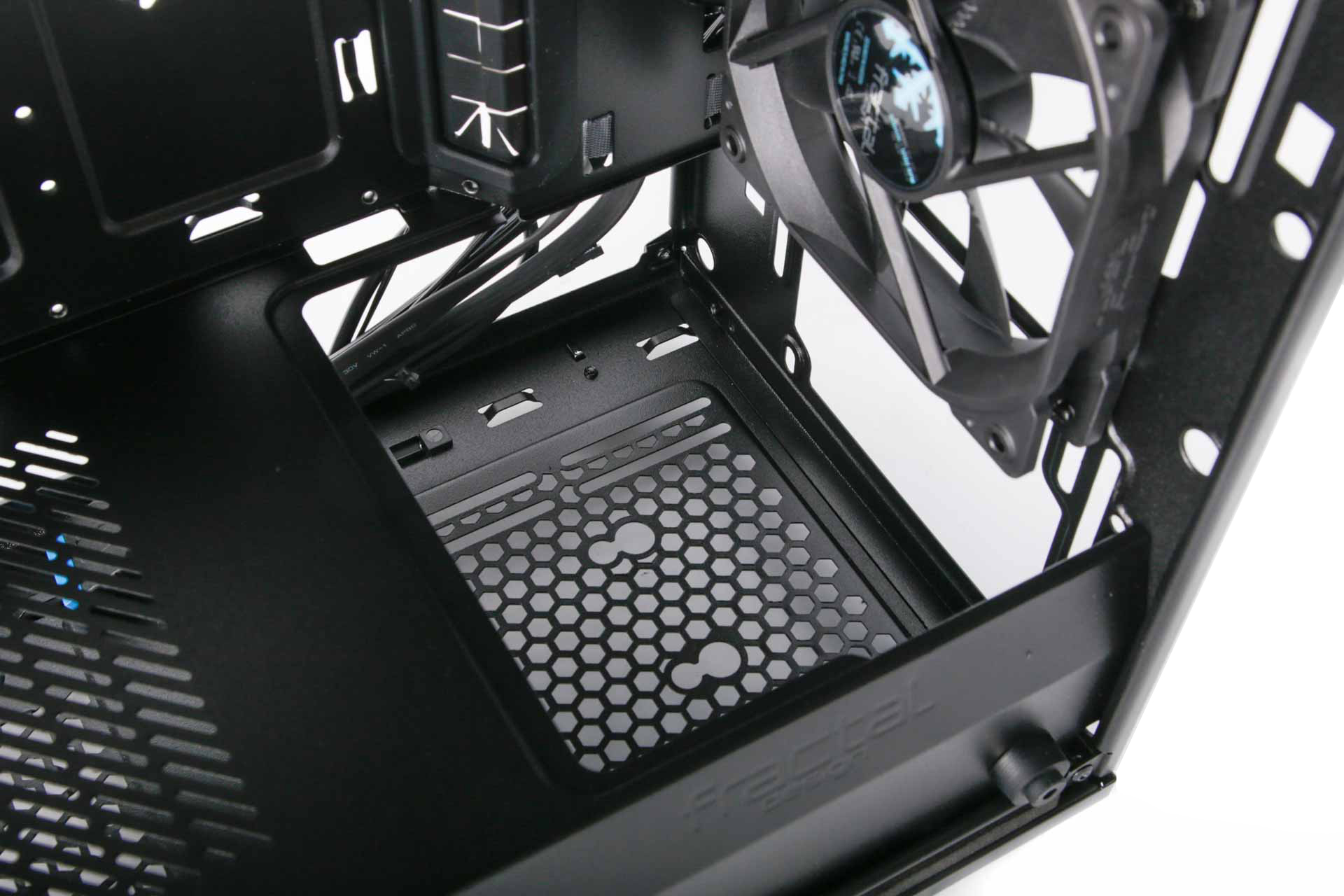

There's a plate behind the motherboard tray that offers a trio of dedicated 2.5" SSD mounts, which means you're very well catered for in terms of flash storage but somewhat limited when it comes to real hard disk bays. The hard disk cage is removable via four screws underneath, and strangely Fractal Design doesn't mention this or the fact that the PSU cover has a removable plate at the front in its case guidelines.
Click to enlarge
Removing both items opens up a huge space that initially appears to be large enough for a 360mm radiator, but Fractal Design's information states a 240mm or 280mm limit. However, upon removing the cage and plate, we found that even a modest-sized all-in-one cooler was about 10mm too long to fit in the front section, so Fractal Design is correct here in limiting the radiator size despite initial appearances saying otherwise. The bigger Meshify C, meanwhile, does officially support a 360mm radiator in its front section.
