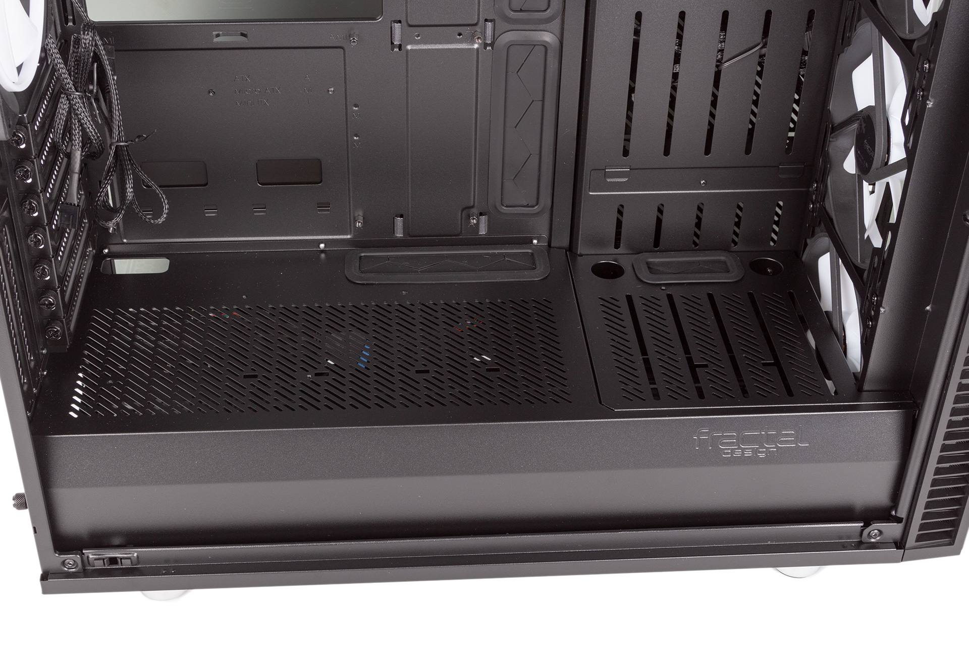

Inside is familiar, as the Define S2 layout is largely carried over unchanged. The ventilated steel PSU shroud divides the case in two, and there’s copious room for CPU coolers and graphics cards. Motherboard standoffs are pre-installed, including a longer central one.

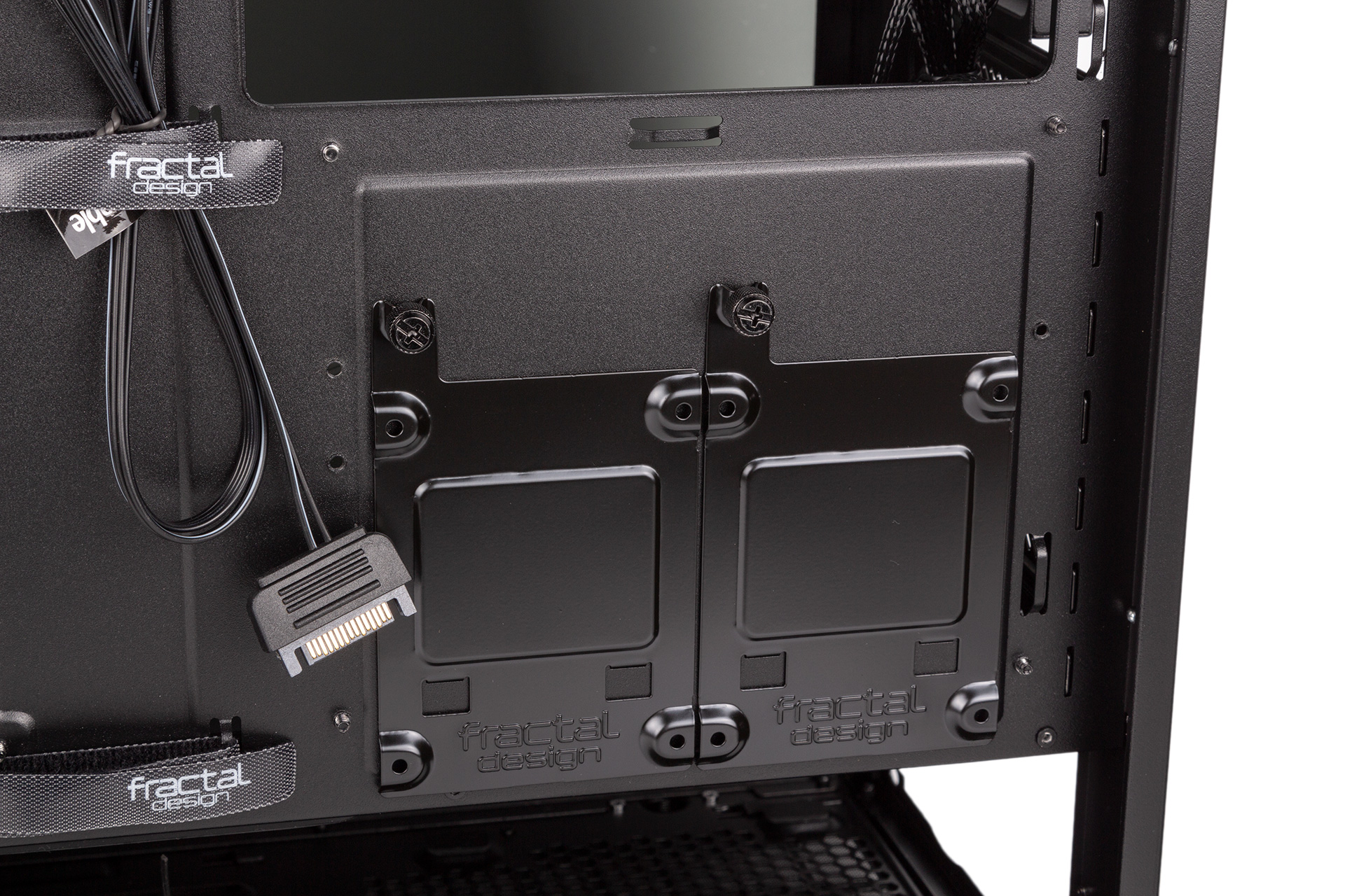

The Define S2 Vision RGB comes with two metal SSD brackets, each independently removable via a captive thumbscrew. By default these are found behind the motherboard tray, but there are three positions available on the PSU shroud (up from two on the original) if you’d rather display your SSDs through the main window. The brackets are also sold separately, so you can expand your storage at a later date.

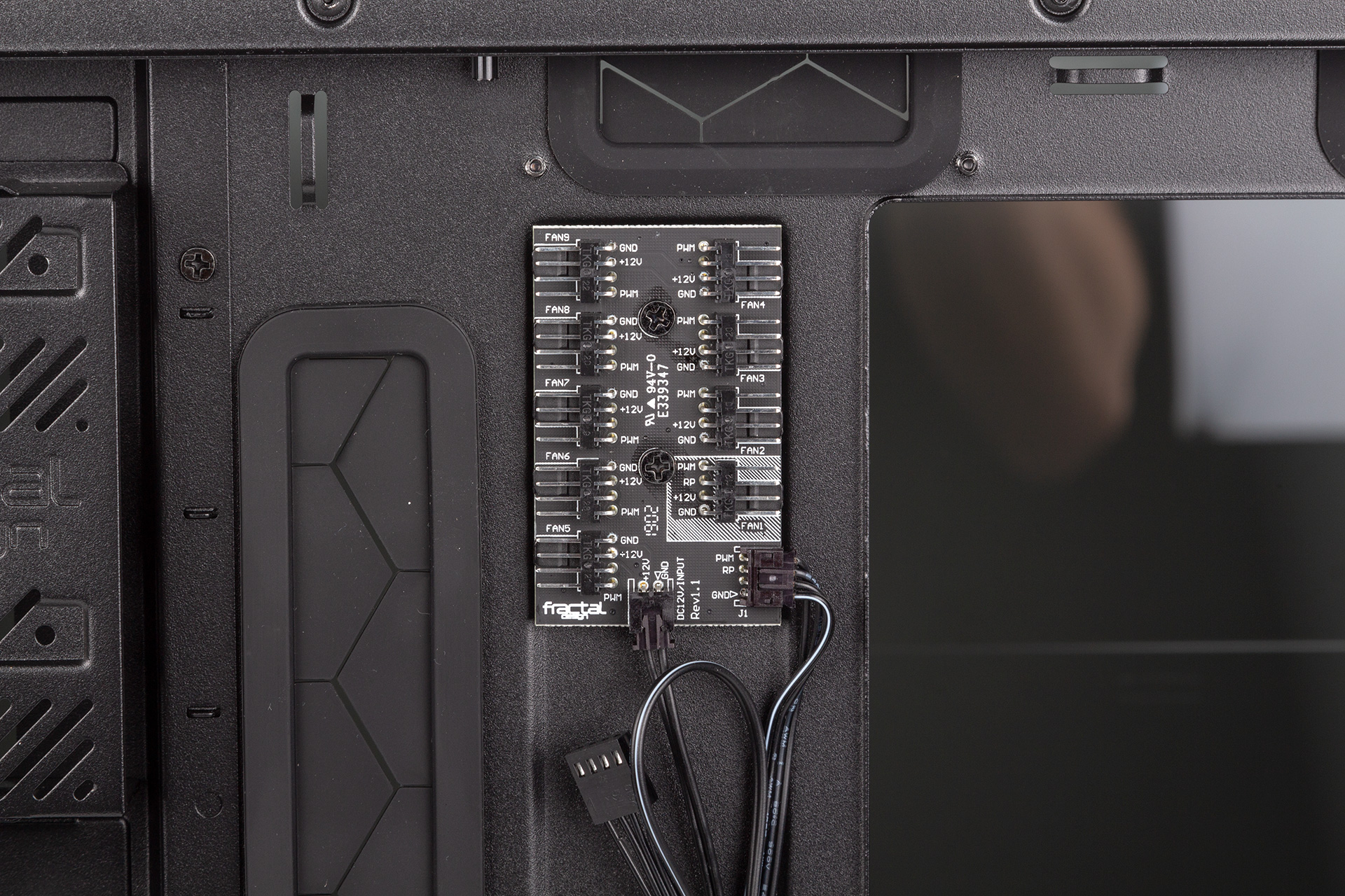

Also pre-fitted behind the motherboard tray is the Nexus P9 PWM fan hub, offering full PWM control for nine four-pin or three-pin fans via a single PWM signal taken from whichever fan header you choose (normally CPU). It’s SATA-powered and supports a maximum current of 3A, so total fan wattage cannot exceed 36W. Fans do not come pre-connected to this like they do with Asus and Phanteks.

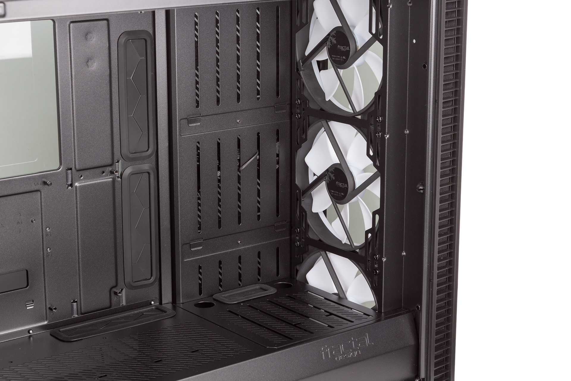

The Define S2 Vision continues a positive trend in looking out for those who want to install custom water-cooling. Starting with radiator support, the front supports 360mm and 280mm (latter cannot exceed 147mm width) and the roof with the cooling bracket installed supports the same, though if using a 140mm fan-based radiator up here your motherboard components including RAM cannot exceed 35mm in order to avoid conflict. The bottom supports 240mm models as well, and there are new tubing pass-through holes cut into the front section of the PSU shroud as well.
That front PSU shroud section has other water-cooling uses, as it now includes mounting rails for reservoirs/pumps, giving you another option along with the vertical struts above that are carried over from the previous design. The roof cooling bracket also includes a dedicated fill-port hole, so it’s clear plenty of thought has been given to this aspect of PC building.
