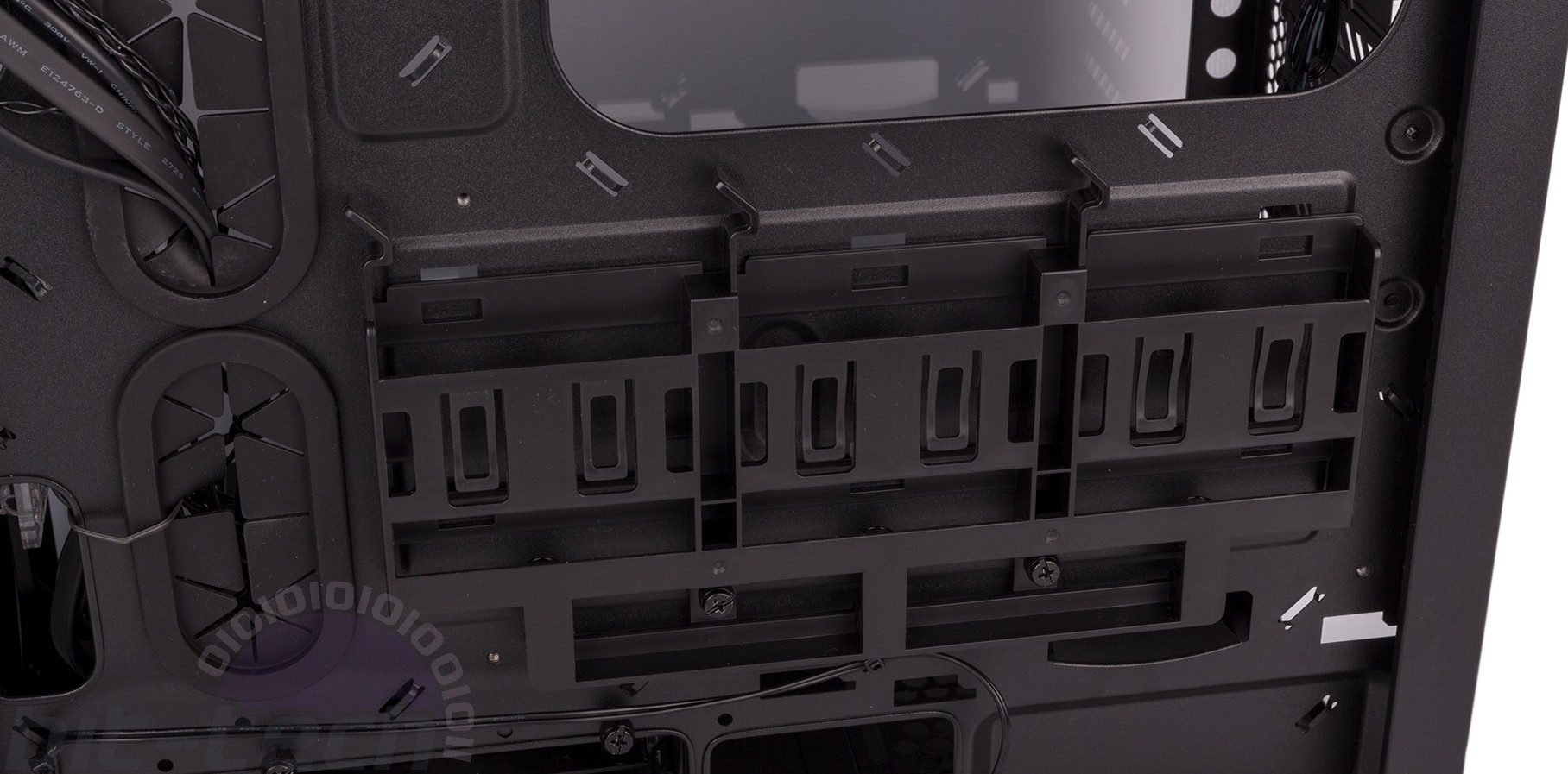

You also get a trio of tool-free SSD caddies, although these are part of a single large plastic frame rather than being independently removable. Still, it couldn’t be easier to use them – just drop you SSD in vertically and the little arm at the top will bend around it and hold it in place. It’s not the most secure hold, but for SSDs it’s fine.

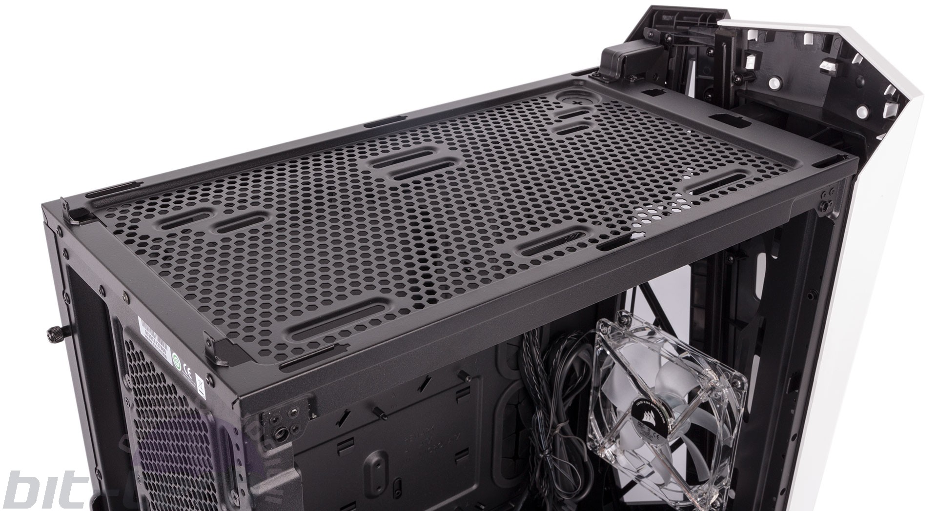

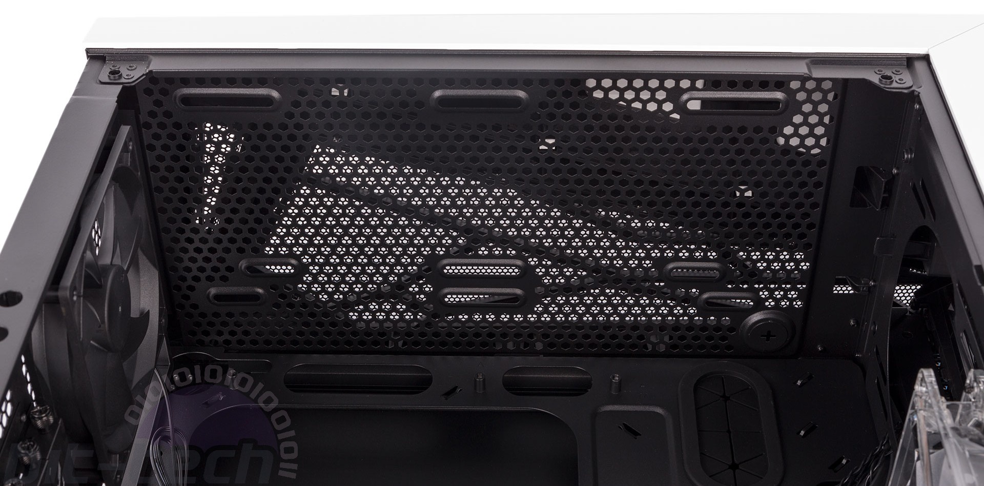

This isn’t really a chassis designed for custom water-cooling, but the roof and front have room for 240mm and 360mm/280mm radiators respectively, which should take care of the majority of all-in-one models on the market.
