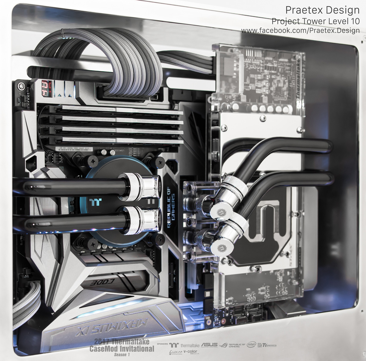

Bending vs Fittings
Another eternal argument is the use of angled fittings and adapters versus bending the tubing itself. This is purely preference; some love one and hate the other, others like a mix, and so on. My advice here would be to see which rigs you think you like the style of the most and choose what works for you. In some ways it's 'easier' working with lots of angled adapters, but the reality is you have to plan further in advance and invest a lot into those decisions.
