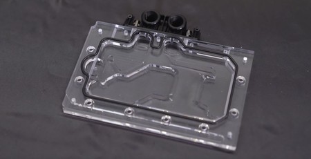

The XG7 RGB GPU blocks are rather different beasts. They're heavy, solid and, I think rather quite interesting. As with the CPU block, the LEDs are hidden behind a front fascia that prevents any glaring lights, and these blocks can also be daisy-chained easily, as they have both male and female connectors. Once again we're dealing with straggly wires for now, but who knows, that may change in the future, and again it's not a big deal since nobody else on the market is currently using a different method either. The acrylic machining on the samples we were sent was fantastic quite frankly; they were astoundingly clear, so kudos to the manufacturing teams on that one.
I also really like the terminal design, utilising the classic shape found on the Dominator Platinum memory heat-spreaders. GPU block terminals are often not given much focus, so I was happy to see some thought put in here. It's important, as it can be the one piece you actually see if a block is mounted traditionally in the PCIe slot. The blocks also come with backplates that feature a sleek, dark brushed finish. They may not be structural or offer cooling advantages, but it's a nice touch to include them in the package.
