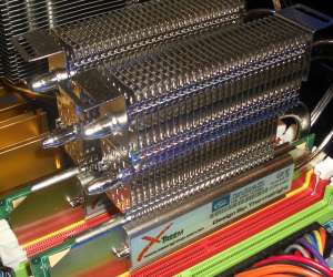

Both sets of performance modules have the huge ThermalRight heatpipe/heatsinks on them which have the two sets of extravagant fin arrays above the actual modules. The problem is that the heatsinks are so large, you can only fit two modules in dual channel, a memory slot apart. This makes it only suitable for Intel systems, as dual channel is available on AMD systems when the modules sit side by side.

Click for Large Images
