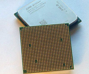

Chips of today (like the A64) may soon be replaced by chips with onboard DRAM.
