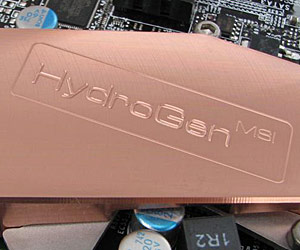

bit-tech has obtained some exclusive photos of the final designs of MSI's new HydroGen waterblock that will be offered as a limited edition on some of its next generation Intel X48 boards.
The block is made in Germany as an all copper design where the water travels all the way from one end the other. This is completely unlike any previous design that we've seen before which has just featured simply a single in-out from a single block on a single chipset or power regulation components by the CPU. This means that you can run a system completely passively as there's no need for some airflow over the heatpipes like with other boards and the amount of flow reducing 90 degree turns is kept to an absolute minimum.
What's more, there are no barbs included, just simple threaded sockets. This means watercooling enthusiasts can for once use exactly the same barb size as the rest of their system, keeping a more optimal water flow.
It looks like finally a motherboard company has listened to enthusiasts' actual needs, however there's no word on the warranty situation, or how it performs without being plugged into a water supply - the pipes are empty after all.
MSI claims up to 20 percent more power efficiency and up to six times longer life because of the continually reduced component temperature. We expect this also means there should be some better potential overclocking too - providing the BIOS (and new X48 chipset) is up to it.
A tentative and early price of €379 may put a lot of people off, but if you're serious about it consider how much it costs for an entire watercooling kit in addition to finding a non-heatpiped board to fit it. From the pictures below, the awesome professional CNC milled piece might say enough to watercoolers to spend the money. Even if you're not a watercooler, we've discovered that MSI is working on its own kit to work in conjunction with it, but is remaining extremely tight lipped as to how this is progressing.
It's essentially no different than the BFG Tech 8800 GTX waterblock we looked at last year, or the Asus Maximus boards, so are you sold or do you think companies should leave watercooling to the niche high end? Let us know your thoughts in the forums.

i like how motherboard companys are integrating water cooling products, but im not so sure about the whole heatpipe array...
Quote Bindibadgi 26th November 2007, 08:58
It's not a heatpipe - it's a single tube that fills with water which makes it travel from top to bottom (or bottom to top)

Looks nice, but I'd be worried about the inner diameter of the copper tubes... Might be good on a sepereate 6/8mm loop, but not on a larger diameter tubing loop ...

Oh yea, totally, but at least this is the first complete solution - it's a step in the right direction if I was wanting to watercool everything. The problem with the Asus ones is that you still need some airflow for the heatpipes, which kind of defeats the object to an extent.

Is it me or does the exit on the southbridge look a little close to the seconds pci-e slot? With a large 1/2" barb plus tubing and a hose clip it could foul on longer graphics cards.
Really like the concept though, much better than the Asus which was reviewed last week in my opinion.

[QUOTE=]From the pictures below, the awesome laser cut design might say enough watercoolers to spend the money[/QUOTE]
Laser cut? Sorry to disappoint but those are cnc milled for sure, as the shape of the piece wouldnt correspond to a leser cutted piece...
Yes, you're right :o

With the placement of the PCI slot, I don't think its a problem. I have yet to see a dual slot GPU water block, and why would you water cool your Chipset etc and not cool your GPU?
I think it is a step in the right direction.

I don't quite understand why all these manufacturers are getting these high end boards with w/c stuff on when all of it's going to kill the flow rate in a 1/2" system.
Quote Bindibadgi 28th November 2007, 12:57
That's because it's a German design = low flow. But that's also no diff from any chipset block.
