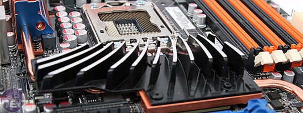

We reset the BIOS to its default values, dropped in a Core i7 965 XE to take advantage of the faster 6.4GT/s QPI bus speed and installed 12GB (all six slots) of Corsair memory at 1,066MHz. We also installed two Zotac GeForce GTX 280s in SLI to load the PCI-Express subsystem as well. The only fans cooling the system were for the CPU and the memory specifically, the rest of the motherboard heatsinks and heatpipes were left to sit without additional airflow.
Firstly we started Prime95 torture test to take up 90 percent of the available memory, then once that had warmed things up a bit we introduced 3DMark06 looping over the top. This was then left for 24 hours in order to see if the board was stable.
We came back a day after listening to fans whirr up and down to find the Asus P6T Deluxe was still completely stable and responsive: neither 3DMark or Prime95 had dropped off and the system wasn't chugging in anyway. This is an excellent result, despite the heavy stress of multiple PCI-Express cards and a full complement of memory.

It doesn't matter that the P6T Deluxe doesn't adhere to a strict category and annoys me in frivolous ways above. Having used the board for almost six weeks it just works well with all the testing, hardware changes, overclocking and BIOS flashes we've subjected it to; that's more than we can say for other X58 boards we've encountered so far.
The BIOS even from pre-launch of the Core i7 CPUs has been excellent, the onboard sound quality is pretty decent, the TweakIT software on its own is very intuitive and works well as we were using it to hit 3.8GHz with early B0 Core i7s back in September. The overall layout works for us and its really very stable - Asus has the basics right, which is important. While we'd love an LED or LCD readout to tell us what's happening during POST, since there's rarely any fuss over memory compatibility or overclocking problems as it just boots without a hoohar - we haven't felt the need for it, unlike other X58s where it's almost been constantly needed.
