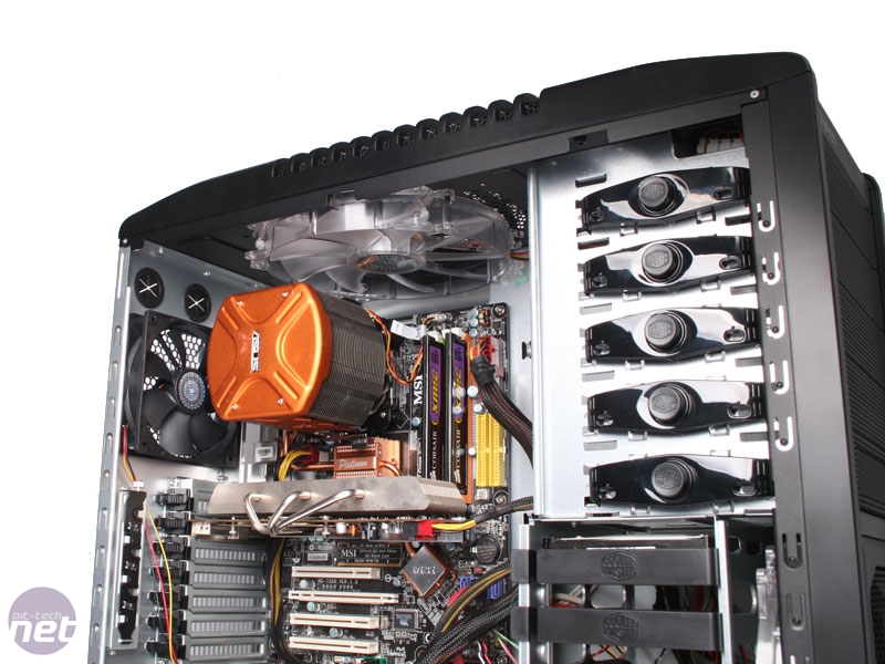

Initially we were mystified with this, but it seems the problem is one of design. The cooling layout of the Sniper means that air from the front intake is pulled upwards towards the top exhaust before it even has a chance to reach the GPU, creating a zone of dead air around the GPU that leads to an increase in temperature. In addition to this the sheer volume of internal space the single front intake has to accommodate causes a drop in the “wind tunnel” effect narrower cases, like the NZXT and Hiper, tend to see more easily.

While the problem is less serious when the intake fan speed is higher (and so blowing air further into the case), slowing down the fans using the inbuilt fan controller leads to some very disappointing temperature results.
With no side panel mounted fan to stimulate airflow over the GPU the meshed side panel is of little use, and despite the negative pressure cooling layout designed to passively draw in air, the sheer size of the side panel ventilation means that passive airflow into the case is unfocussed and ineffective.
Of course this problem is easily remedied by fitting a pair of 120mm cooling fans, or even a 240mm fan into the side panel fan mountings, but the fact that the Sniper seems to perform so poorly without them is still of some concern. We really have to question Cooler Master’s decision here to omit the 240mm side panel fan from the retail box of the Sniper – it would have had an enormously positive effect on the cases out of the box cooling.
