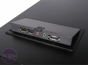

Eagle eyed readers will have spotted the lack of a visible front panel on the NZXT Whisper – that’s because, like the Cooler Master ATCS 840, it’s recessed into a pop up hatch on the roof of the case. Yet again we find the build quality extremely suspect, with the mechanism consisting of just a bog standard spring and a simple catch all that’s behind its pop out action. While it works fine, it just doesn’t feel very secure or solid and like it’ll last – a concern which proved correct when we managed to break it during testing, explaining this exact point to others. Whoops.
The panel itself packs a pair of USB 2.0 ports, microphone and headphone jacks with support for HD and AC'97 onboard sound and an eSATA connection, which while not as extravagant as other front panels that including Firewire and four USB 2.0 ports, should certainly suffice for the majority of users and eSATA is always a useful update.

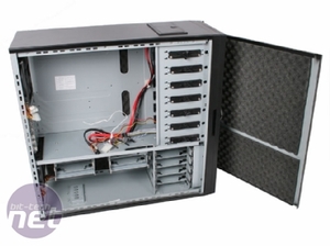

Both side panels are easily removed, secured using two thumb screws each at the rear of the case, immediately revealing one of the features hoping to make the Whisper one of the quietest cases currently available – sheets of 5mm thick high quality noise deadening foam glued onto the inside of both side panels and the riveted unremovable top panel too. The foam doesn’t interfere with the removal or refitting of the side panels at all and certainly looks like quality stuff, shaped in the familiar egg box style and spongy texture that is best suited for deadening sound.

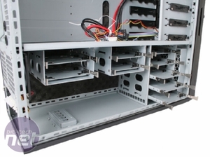

Looking inside the case itself, the main chamber has been divided to create two compartments; one at the top for the motherboard and 5.25” drives, and another at the bottom for hard drives and the PSU.
This lower compartment packs in mounts for a whopping nine drive tray based 3.5” hard disks. Five of the drive mounts are built into the main hard drive cage and then two additional removable cages with two mounts each are suspended from the divider that cuts the case in half. The trays, while not flawless in their construction (the steel used for them is notably scratched and blemished), are solid enough, although some were very stiff to remove and reinsert into the slides. All the trays do have very good silicon mounts for attaching your hard drives to, which goes a long way towards lessening hard drive vibration and noise.
