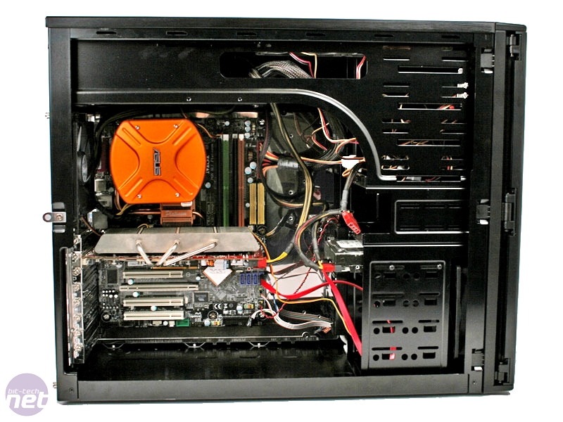

Frankly, the Omega was a dream to LAN with. Due to its aluminium construction it was easily carted around from car to desk, and with the improved cooling setup kept my overclocked rig perfectly stable even under the sweltering heat of a room filled with 2,000 sweaty gamers and their PCs.
Even when some on-site repairs were needed, thanks to a USB Dictaphone causing CMOS checksum errors (Dictaphowned - Ed.), the Omega was easy to pop open and move around inside of. This was simply down to the extra large dimensions and great internal layout of the case. The only thing the Omega might have lacked was some eye catching style - it is something of a nondescript black box after all, although some modders certainly saw to that.

The Akasa Omega has been a pleasure to work with from start to finish, and I feel it is without a shadow of a doubt, the single easiest case to build a system into currently available. The brilliant motherboard tray design makes such a huge difference when building your system, and for those who frequently tinker inside their machines it's of enormous advantage. The build quality throughout the Omega is equally excellent, and is a breath of fresh air after so many recent cases we've reviewed have struggled to just get panels to line up properly.
