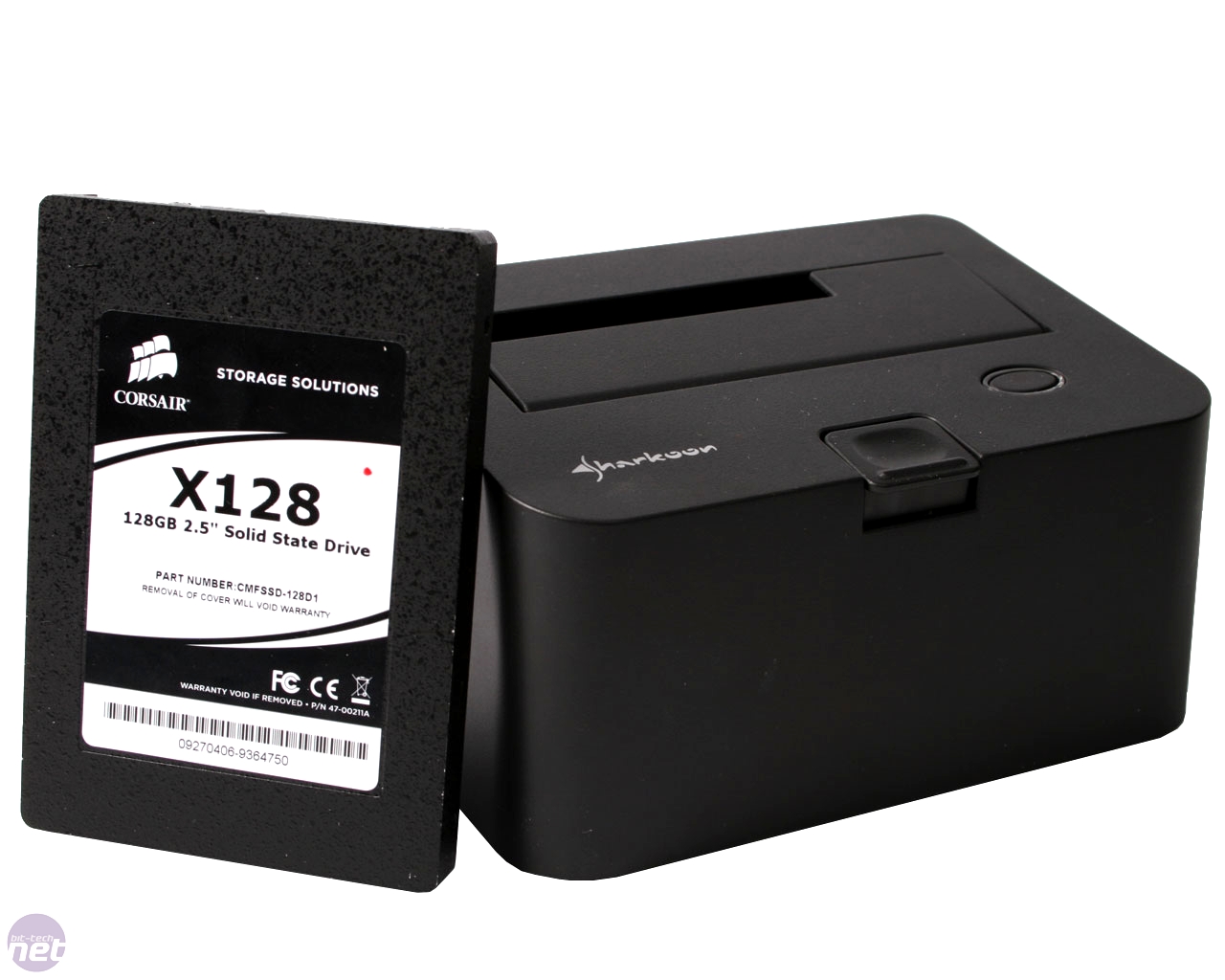

Using our Indilinx-powered 128GB Corsair X128 SSD and the Asus U3S6 card, we should have seen results identical to those of SATA 3Gbps, where the limiting factor is the drive and not the bus. Sadly, this wasn’t the case, with the drive performing a fair margin slower than on SATA 3Gbps. Average read speed across the drive dropped by 40MB/sec (320Mb/s) by switching to USB 3. While average write and burst speeds weren’t as badly hit, the dip in performance from switching to USB was obvious.
Bizarrely, the Sharkoon USB controller card was even slower than the Asus by a margin of roughly 50MB/sec (400Mb/sec) across the board in HDtach. We’re not sure why this is – both cards use the same USB 3 controller chip, and the 1x PCI-E connection of the Sharkoon provides 500MB/sec of bandwidth, which is far more than our 140MB/sec SSD required. Not all USB 3 cards are created equal, it seems. Possibly the Asus card boasts superior firmware, or else the 2x PCI-E connection does offer a benefit, but we can’t be sure which.
These dips in performance in HD Tach when switching from SATA 3Gbps to USB 3 translated into our sequential file tests using FC-Test. The Asus USB 3 card delivered performance that was consistently 30 per cent slower than SATA 3Gbps on write and copy tests. The Sharkoon USB 3 card was slower still. Interestingly though, read speeds were much closer to SATA 3Gbps speed for the Asus, which delivered a sustained read speed of 186MB/sec when reading our 1.6GB ISO file pattern. This was an enormous improvement over the 32.6MB/sec sustained read speed of the same drive when we switched it to USB 2.
First Look at USB 3 Performance Performance Analysis and Conclusions First Look at USB 3 Performance Performance Analysis and Conclusions
Click to enlarge - An SSD and USB 3.0 drive caddy were more than a match for USB 3.0 at this early stage
