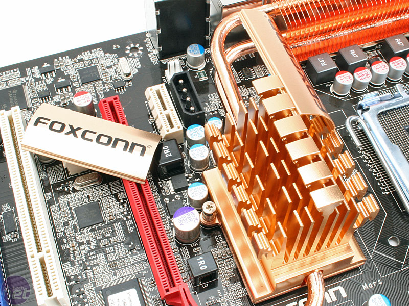

Cooling

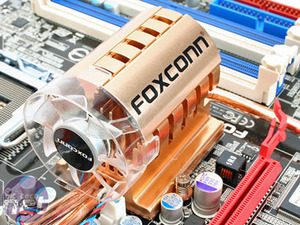

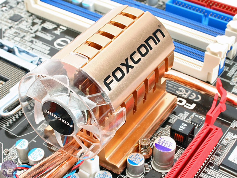

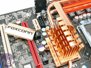

A simple heatpipe array snakes through the centre of the board covering southbridge, northbridge and just four out of the six mosfets. The central northbridge heatsink looks just like the “engine-esq” one found on the Foxconn nForce 680i board we reviewed earlier this year, but this time the fan is now entirely optional. No fan is included for the mosfet power regulator area though if you’re water or passively cooling the CPU, and Foxconn doesn’t state that one is required in the manual however we could advise that there should be some airflow at least.
As stated, only four of the six mosfets are cooled, which means the other two will be inherently hotter and are likely to be your limiting factor sooner. In addition, they aren't even placed in such a way that makes them easy to cool even if you wanted to.
The optional fan for the northbridge heatsink goes on just one side and takes a little finger effort to flick on and off. Also, being just 35mm in diameter, it’s a little whiny. The two Foxconn branded panels on the top slide off if you want to get to the fins underneath to provide some alternative and direct airflow instead.

Power Sockets and Connectivity
The 24-pin ATX and 8-pin 12V power sockets are very well placed around the edges of the board, however the additional Molex power socket is nestled on the inside edge, between heatpipe, rear I/O, two fan plugs and PCI-Express x1 socket. It also means you have to drag a cable (with other Molex connectors you likely end up sacrificing) across the face of the board as well, making it look untidy and potentially hindering airflow.
